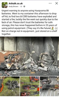

yeah, what spawned this tread was a photo I saw of a bunch of fried equipment, I THINK it was the big orange company brand and seemed like all the tools were a total loss. Got me thinking that would really suck, more over if it was the truck too.
Friend near me had a construction tool battery burn in and total a truck. Not sure of brand, aftermarket or stock, or abuse it was put through - so it can happen (perhaps).
Story facts are a little to fluid from him for me to try asking about it a third time or more.
