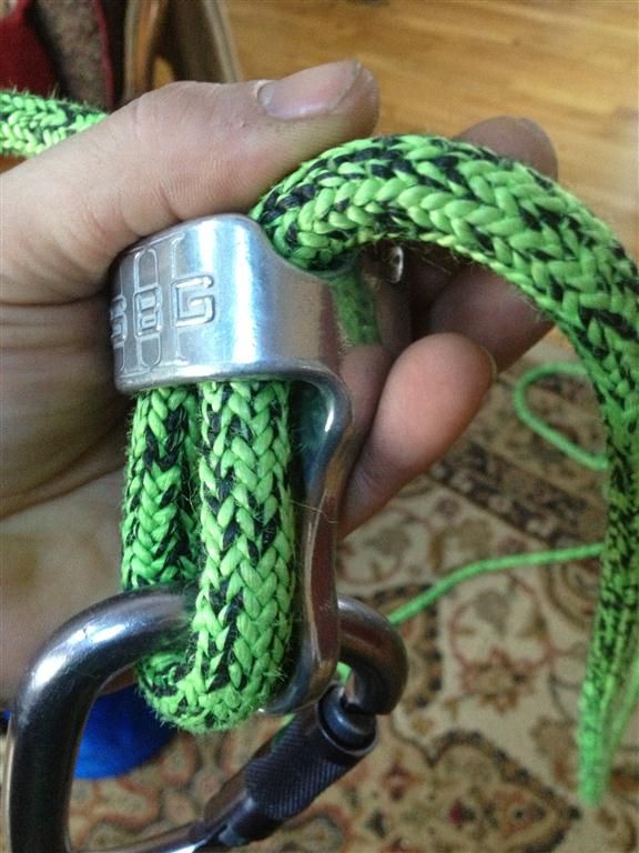

Hey jakers, welcome to the buzz. A ring as a stitch plate isn't a bad idea but I'd prefer this thing after giving it some short runs.

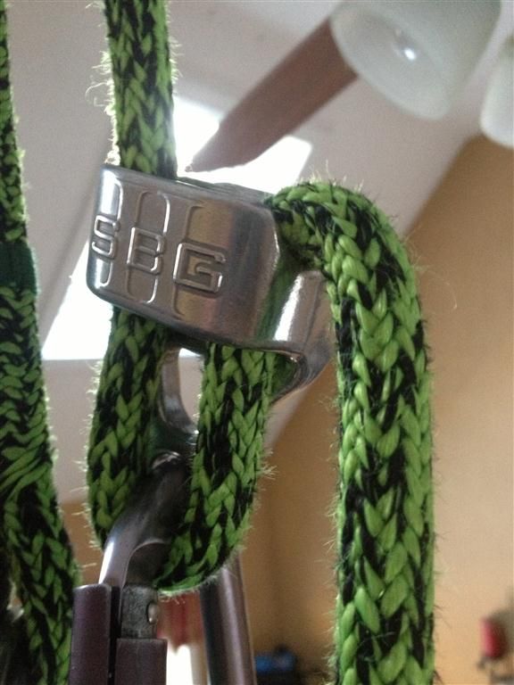

I've never used one of these before so I'm probably more impressed than someone who has experience with them. It weighs nothing, doesn't hockle the rope, has a couple holes for different configurations, and has channels to keep the rope in line. I can't really see any reason to use my 8 over this thing.
Here's a few pics. The rope is imori (12mm)
The first picture is under load. You can see in the last picture the difference in the slot sizes to accommodate smaller rock ropes.

Adam, the different grooves in your SBG re to provide varying friction. Putting the brake end of the line through the deeper V groove will give you additional holding power. Especially when rock climbing this can be a great benefit.
I imagine with arbo ropes and managing just your own weight using the shallow grooves will work best.

The Omega is what I use and have been for the last couple years. No problems with the 12mm I've noticed. For some pine work I climb up, working on the way up and I have a 8mm line I use to just get down. The smaller side works well for this. Also the two holes for biner attachment will increase/decrease friction...

I may have to return my unused ATC and go with the SBG. I'm pretty sure mine won't work with the larger rope, and I really like the solid keeper/ability to adjust the friction.
