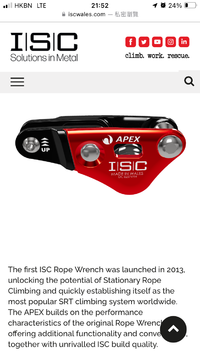

I had been under the impression that mechanicals had to have a "fail proof" feature like the ISC D4 or whatever the Petzl do-dad is, for example. Since then I have realized that isn't the case, but now I really have no idea. At a gear check I often have the luxury of saying, "Go ask Jason Diehl."
I don't believe it needs approval, as it isn't the primary life support device - the hitch is. You don't see the original Rope Wrench on the list of approved devices, either.
You missed a lot of the drama! It wasn't until the rope wrench got a ce cert was it allowed. I have no idea about the apex thingy.
I wonder if the CE cert delved into the loading of the hitch. A DRT hitch load is pretty straight forward pushing the working essence to hitch cordage properties, eyes/terminations/knots and hitch formation. Is that actually inspected? For SRT the RW splits off some load from the hitch whilst the single line support ups the hitch load - was any of this proportioning taken into account for SRT RW CE cert?
It's worth pondering even if the inside story can't be publicized.
The ce is a system tied with a specific hitch cord on a specific rope tied in a specific way. Once you do anything outside of that it's not ce anymore. But in the world of competition climbing there is a bit of common sense about it in that regard.
Was the RW CE cert still in the floppy tether days or using (semi)rigid tethers? The Carey Gibson issue was pretty early on and may have played into it.
The list stated Taz Lov3 – Approved (Planned updates to the ISA ITCC Rulebook will prevent any contradiction or prohibition in use of this equipment. The Taz Lov3 is approved for use at ISA TCC events as of 2 December 2021).
Does anyone know what has been updated on the latest rule book? And can anyone speculate any reason behind this statement?
