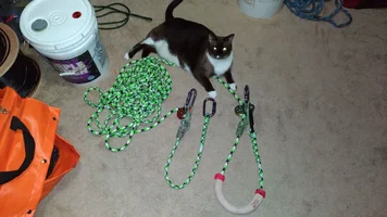

Climbing system? Umm, buckingham climbers with the crook leg tree spur, an old wide saddle my boss gave me, turned an old piece of rope into thigh straps, 2 flip lines I made my self out of good sections of old rope, both with self made prusiks one with a pulley for self tending.IMG_20180823_172427.webp
