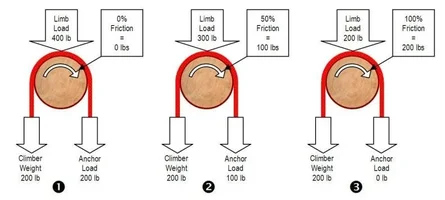

why would you be able to se a higher tip? the forces are doubled on your TIP with srt on a ground based anchor
Im not sure of the physics maybe Tom can elaborate. But for me I can set higher TIPs because I can back them up. If that higher TIP fails, I set it up so that there are severa other crotches that can catch me. With Ddrt, You have to rely on one single point of attachment.
imagine almost setting your line on the outside of the entire canopy so the forces are distributed by lots of little branches. It can make for a bouncy ride buta higher TIP is always worth it right?

Jack did a nice job of illustrating how friction at the TIP will reduce the load. I've done a demo of this using cord and either a fishing scale or 150# game scale. It is interesting to see the load reduction by spiraling the rope down the tree to the ground anchor.
