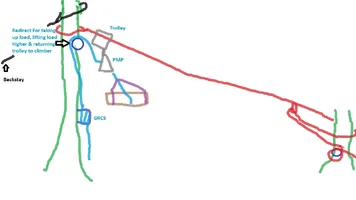

Usually when we zip-line we'll hang a PMP under the trolley, pull the trolly to the high point, run the load line through the pmp to the load, pre-tension the load line and lift the load to the trolley.
We then use the load line to ease the trolley down the zip line.
All this to say, that with the PMP hanging under the trolley we don't need the plate to keep it from flipping.
(See Attachment)
Since there are only two things we need attached to the trolley, the load PMP and a tag line, I wondering if the expense of the plate is worthwhile.
This is why I was thinking maybe an AMSTEEL sling for hanging the PMP along with the Taglines.
