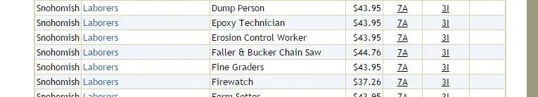

For me, the easiest part of prevailing wage work is having the $ for paying the payroll. The other things that go with prevailing wage take me a lot of time. You need to start with the state prevailing wage notice that applies to the project. It will list the labor codes and class along with the Basic rate, Fringe rate and Total rate. Then choose the closest labor code for each person.

I took guidance from a friend so has performed many prevailing wage jobs for municipalities. We paid worked under the laborer-feller bucket class. You can look up the rate under the WA LNI website by county. I paid truck/trailer rates for the travel time.

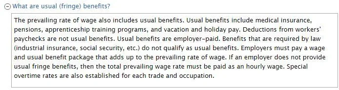

You have to calculate in what are called 'fringes' as well. This means whatever benefits a union employee would get, divided out over a period of time. Figure an additional $10-13 an hour on top of the prevailing wage. Madness.
