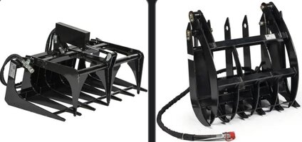

I like the klou. However, I was originally thinking something along the line of these Screenshot_20240630_192721_Google.jpg
I thought these might be better for cleaning up homeowner brush piles, or trees that are brushed out without cleaning up as we go. This happens fairly often with a grapple loader truck, as you don't have to sort the logs and brush afterwards and the brush offers a crash pads for logs reducing yard damage without having to rig.
The larger width should help straighten up brush that isn't exactly stacked neatly and the multiple tines might be better for picking up rakings.
Neither of these could do some of what was shown above, but I feel they might be better at some things too.

I have a 8 y.o. bmg and got the grapple in the first picture for under $1000. It's been useful. I like it.
The grapple doesn't open far enough to be optimal.
I think that the second looks better.
