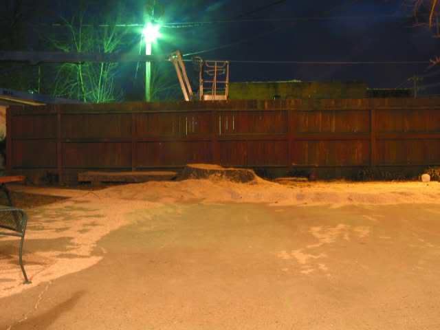

Nice job! how come on the last cut you made it so high? What would you do or the better question is how do yoo pic such a small flush cut. Wouldnt it worked better just to cut at grade so theres no small round to handle?
Here's why we cut it high.
The lift and operator weren't that much 250-300 bucks or so for an hour.
