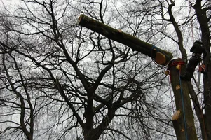

Been using them almost exclusively for many years Tophopper....only ever had one issue where I thought the main bush had too much play. The dealer replaced the block and I never heard back. On a precautionary note a climber sould try to ensure that the pin of a loaded block couldn't twist amd press against the tree. Other than that, no faliures here.

cause it's a heavy BEECH and two is better than one.
see my video at 7:25. That is two blocks, two bull ropes on that peice too. Nice to do on heavy stuff.
Re: ISC rigging blocks
Reg also mentioned that with two pulleys it gets the pulleys to the side out of the block slam zone.
I think mostly though he was showing off the twin bollard Stein.
Making the most of the situation Dan more than just showing off....and it is part of my job afterall.
I think if I referred to slamming, it would've been in regards to the blocks colliding with each other if they were set too close together....the two adjacent half-hitches where the lines are tied to the log are also pushed far apart for the same reason.
Also, as I recall we had to stop that log quite abruptly and in doing so made sure it would pass between the two lines before it smashed into the spar.
And Beech is heavy stuff for sure.
But back to topic, I've hammered those Block many times year after year and never had any great cause for concern, even though I'm admittedly careful in routing the line so the pin sits on the outside.
