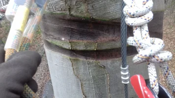

This is the damage that a sling has done to a beech, I just came across this example today. This one was just left on too long, but you can see that it's not great for the tree. This in not a very bad case, because beech grows relatively slowly. The spruce that we have a lot will bulge much quicker. All in all this is a great method of attaching to a tree semi-permanently, but you will have to move the sling regularly. The advantage is that there will be no damage to the tree after you're done with it, if maintained properly.20200122_112535.webp

I don't have Beech in my area to speak of. If that beech that is pictured above was a local maple, with that vertical seam, I'd expect internal decay.
