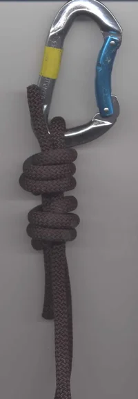

I have a slight variation of the fishermans knot attached. I know it may be hard to tell but the other side of the loop is captured in the knot as well. You can slide the knot down to the biner and it will reduce the chance of crossloading during the loading and unloading involved in footlocking.
Dave
PS- I do not use non locking biners for this, it was just handy for the scan.
