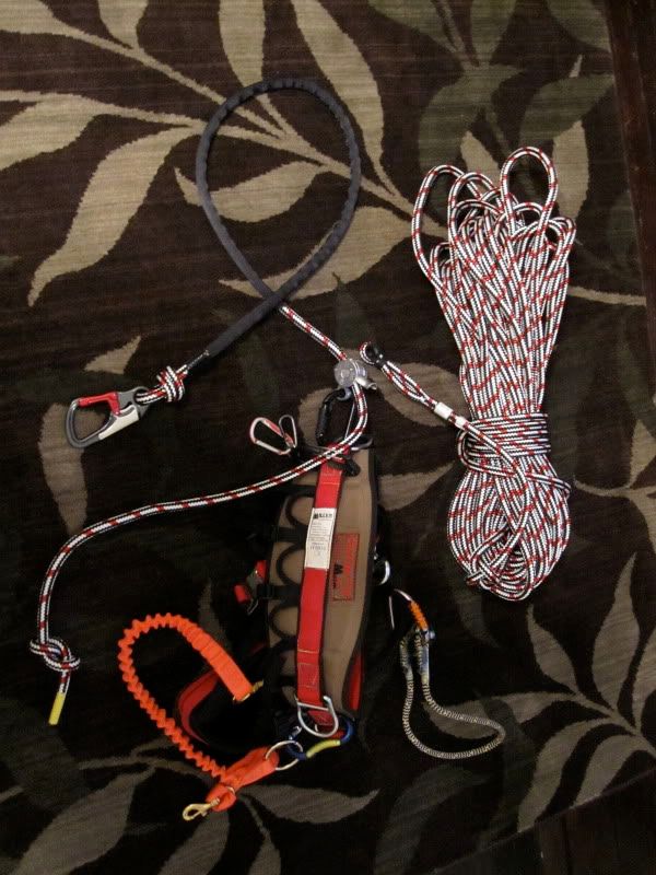

I also use a small climbing system. 25 ft Poison Ivy with tight eye, 2 amd biners one for tenex eye and eye the other for a snap , and a small swivel to tend. The tail goes through my fig 8 on an no locking biner and into my ditty bag on my saddle.

Bear with me and I'll shoot a picture of one of the custom SESA lanyards I like to make for my friends... and Easyphloem.
