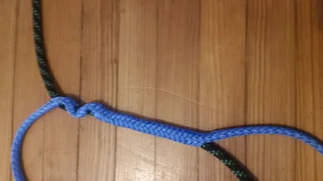

Have you tried doing something like this? This thing grabbed everytime just messing with it anchored to the wall. It was a bit touchy on the release though
