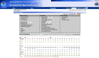

This is NOAA's Tabular forecast. Put in your zip code and scroll to bottom and click on Tabular Forecast:
This gives you hourly forecasts for multiple parameters you set up on the click boxes . If you look at this forecast the night before and then refresh it in the morning you can compare the numbers to see if conditions are trending towards the prediction or away. I am amazed with how accurate it can be. I've used it for everything from planning spray schedules to predicting flying conditions for paragliding. With practice you will gain confidence. After 15 years of living in this area I have become pretty good at judging local conditions and trends. But, what I've learned over these years, if it looks questionable it's best not to cancel the job the day before and to wait until you're actually on the job site.
