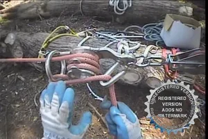

Does anybody know anything about this?

Never seen it. Looks like a brake drum attached to a MA system (going out the right side of pic).
Doesn't it look like it needs the end of the rope fed around the drum? Anybody see it differently?

It looks like a really well designed and built friction device. I see no indication that it has any moving parts.
It could be called 'Take three wraps' if that name isn't already taken.
Looks like a friction device to me as well. Take a bigth and pass through that round ring on the front, and then spin wraps on after that, use the hook to lock it off.
Thats what I got from the picture at least?
I believe it IS one of Jerry B's lowerig devices, In fact I think those are his gloved hands,

Baggy gloves? That device is version of a portawrap I made about 15 years ago. In the pic it was being used as a rope grab at the end of a tackle for drawing and then lowering.
When used as a termination/grab for pulling it's gentle on the rope. A regular portawrap could be used the same way though.

It doesn't see a lot of use, Chris, because it's only good for half inch line and is a bit cumbersome to load. Funny though, the design is fairly close to the modern portawrap, but came about as an idea sometime before.
Goes to show a lot of people in the business have similar ideas at about the same times.
