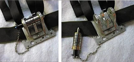

My solution was a 2" adjustable webbing sling with a micro pulley I made, that clips to the back of my harness. I still use it for long climbs like in forest trees, but I found my arm strength increased enough that it is overkill for short climbs. You can see it here, I just let it hang once I reach the canopy.
After reading about these chest roller ideas, I decided to see what I could do with what I have. Clipping the pinto that stays on my saddle to my weaver chestie seems like it could work. Haven’t used it yet, just toying in the office. I just need to be able to shorten my bridge a bit on ascent to keep my hitch from being collapsible if I pause to cut during my initial ascent.
I like using gear I already take with me and won’t be needed for one task while being used for another, i.e.- ddrt redirect vs srt retrievable redirect vs chest roller. Different functions at different times of the climb, no extra gear.
