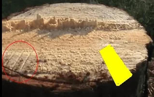

This is what I mean by wedge placement.
If the wedge is placed on the far side it will lift the tree towards the thicker part of the hinge compressing it causing it to hold longer and help turn the tree.
Stump shot will add more wood to the hinge also.
More wood in your tapered hinge will give you better force for turning the tree.
