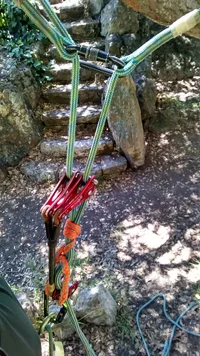

really? i've been doing a bit of experimenting with that lately looking at a different way to set it up and a different way to work it ;)
There is real beauty in flipping things over, I'm convinced that the symmetry in Eric's DSRT system has a deeper resonance than function and this of course leads into asymmetrical ideas, 2 systems become 1 system become 1 and half systems and reverting, the constant change through desire of movement. But playing so much with systems I am drawn back to the lightweight 8mm in TRT....and that it is effectively a loop that can be turned upside down lends itself to many rigging puzzles.
I can only see a reason for such large TRT rope (11mm) if you want to kill many birds with one stone, ie hit SRT, DSRT and TRT all in one go but for me that loses something of the freedom that 8mm TRT gives.

I'll agree with about all that. Funny that I find the 8mm line so light, but more fussy to manage than 11mm. Makes me wonder if a 10mm system could be constructed with appropriate mechanical hitches that work SRT or "Shared" SRT. Whoop!
Some of you are running two rope in one device using 8mm rope or so. My question is...wich rope are you using. If I'm not mistaking it's the same approach has twin rope for ice climbing or general mountaineering . I was looking at mammut , petzl, or edelrid rope in the 7.7 to 8.7 diameter at the store today but the static elongation ( at 80kg) is around 6.8 % wich is not fantastic for treework. Do I miss something ? Or you get along with this type of rope? Thanks
Hmmm, yeah, it's difficult to decide which way to focus on it, I certainly felt that way and asked Kevin what the chances were to get a 20mm rope runner made up, still waiting a year later so I ran out of breath. I'm more interested in using the highline of TRT and using pendulum climbing ala DdRT rather than dedicated DSRT, I've done a full circle since Oceans last came over.
