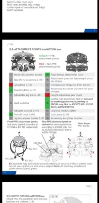

I don't think the back ring is rated for bucket or other fall arrest attachment. That requires a full body harness with a dorsal attachment. Also, the TM is only rated as a sit and work positioning harness.
Thanks for the adding"full body harness".I completelly forgot to mention that for buckets or MWEPs your TM harness takes an upper bit called a chest harness...but all this cames from the booklet that came when I got a brand new TM harness...I dont know that much on the subject...except TM is a decent belt done by Treemagineers,some of them actually climb trees and use saws

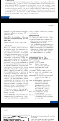

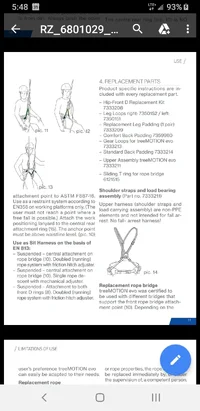

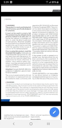

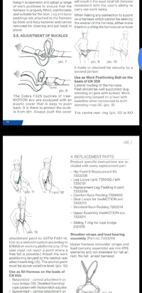

You might want to reread the booklet that came with your harness. There is no chest harness that makes the treemotion compliant as a fall arrest harness for bucket work. The harness is strictly for sit work position or very specific platform use on the rear ring.
Relevant pics from the treemotion Evo manual attached.
right this info you gave me is not what I got from Teufelberger,but then again...when I got this harness there was no TM evo...still EN358 is"restraint on working platforms"and my harness has chest hook points,never used...and yes this is not fall arrest harness
