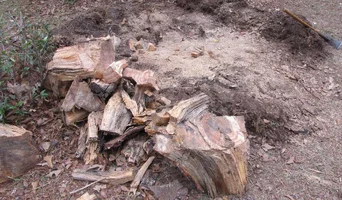

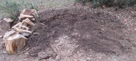

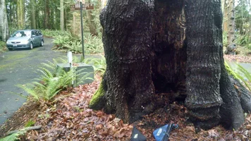

Did a stump removal getting the last goody out of a worn-out bar and blade. Saw a bit, attack with sledge hammer and wedges, rest a bit, repeat. Had to touch up the chain twice while the saw battery was recharging during the afternoon of work. Good exercise. Nobody rents stump grinders around here.
Mr. Winchman, I do believe you are in better shape than I am, and I am about half your age. I must compliment your conditioning, and hope I am in half as good shape when I get to your age!
That stump looks as big as any I've ever dug by hand. I kinda like the challenge. So far I've never rented a stump grinder (only worked on my own trees and next door). If they're bigger than that one I just cut 'em at ground level and let them rot on their own.

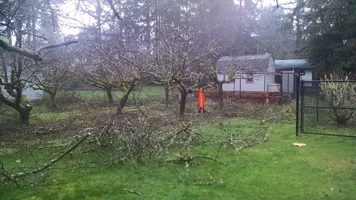

Made a mess for a homeowner to clean up.
Neglected orchard of 9 trees.

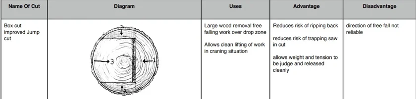

Fun read!! I had to look up box cut, but it looks like you proved what it says about its disadvantage.2020-02-09_box_cut.png
I recall seeing a video of a cut that may have worked better in your case. A notch was cut first on the side toward the desired fall. That was followed by two vertical and one horizontal plunge cuts to form a narrow tongue from the tree down into the stump. An angled plunge cut severed the part of the tongue below the notch and hinges. Cutting the outsides from the back left the hinges intact for the pull. As the tree fell, the tongue continued guiding the tree long after the hinges broke. That's a lot of work. I've never tried it, but it looked like it worked pretty well.
Fun read!! I had to look up box cut, but it looks like you proved what it says about its disadvantage.View attachment 65279
tongue and groove ... good for any timber that doesn’t split spar wood easily...

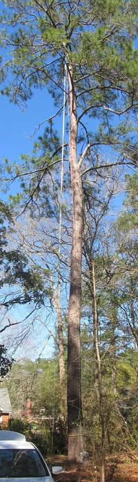

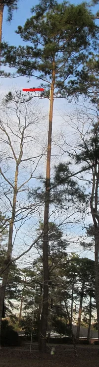

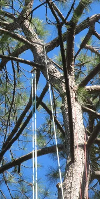

I had a nice 65' climb this afternoon after finally getting a line up to a decent TIP in this tall pine.
Got rid of seven dead limbs two to six feet long and mostly about two inches in diameter. It was my fifth climb in the last seven days. All the others were shorter oaks, so I was looking for a longer climb using just my arms.

That's a shield to keep the upper pulley and rope from binding against the tree near the TIP. It's hard to control which way the pulley is hanging or to see if the rope is touching anything. It's probably beefier than it needs to be, but it only weighs a couple ounces.
