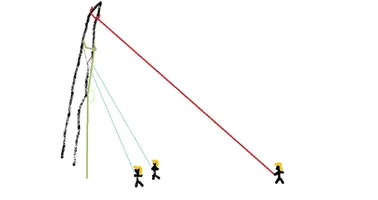

This is what I was thinking. Note the mullets on the crew. They were going to be helmets... a Hel-mul-et.
I suspect that it wouldn't work perfectly, but wondering if anyone has tried this set-up. Perhaps cut some of the holding wood from the sides, leaving either a hinge with triangular holding wood (as suggested for heavy leaners in Berenek's FGTW) or a sorta Coos Bay-ish strip of holding wood for the cable saw to cut.
Again this would be for catching a top on a compromised trunk where the climber would not have an alternative TIP, so would descend to a more solid TIP or the ground.

Bing is right your standing right under where the load is going to fall. You better be a fast running.
I figured that one person on each side of the drop zone working together would work, again only in the very rare situations.
I wouldn't stand in the dropzone.
