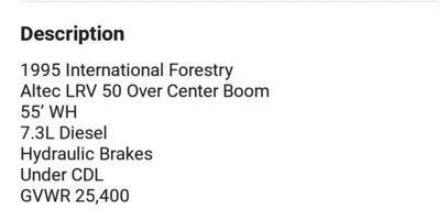

Hello, I am going to look at a used bucket truck this weekend, a 1995 international with a altec LRV 50 boom. Anyone have any thoughts on this particular truck or boom? I know it's a little older than some of you would look at, but buying new isn't a possibility for me at this time.
Thanks in advance for the input,
Justin

Make sure it has a current dialectic verification by Altec . If it doesn’t don’t waste your time . Shit gets pricey fast
For what its worth, I steer clear of power lines anyways with the exception of a feeder to a house. But I will definitely be asking about boom inspections and certifications
They are built solid. I would beware of the juice brakes though.
Are they prone to leaks on this truck, or bigger issues? I have a gmc 7000 with hydraulic brakes, its has needed the brakes replaced but no serious problems with the brake system.
With regards to the brakes, i just don’t trust a larger truck with juice brakes. If a line goes then the truck is going to have a hard time stopping.
The altec boom is good. If you get the truck PM me and I’ll give you the altec road service managers cell. He told me to call him directly to schedule if there an issue on a jobsite.
