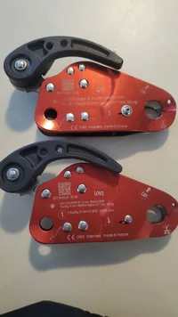

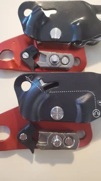

I received the new Taz Lov2 today. After inspection, I see no differences between the two that would affect performance. I'll probably try it out tomorrow. There are a few differences aesthetically like the coating and the rope path line. Also I found that the little black cam is removable/replaceable on the older model and is riveted in place on the newer model.
