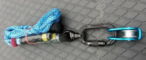

First pic is just an ultrasling with swivel and pulley... later made a couple with OmniBlock 1.5 pulleys... fine if you are climbing to the DdRT TIP using SRT, spurs or a bucket truck to set the canopy anchor. Later still, I started making anchors that I can easily install and retrieve from the ground, like a R&R friction saver. I don't like any rope going through a crotch while loaded, not even an SRT line. Call me crazy, I don't care. The second pic is a very recent prototype that I can use with both SRT and DdRT.. shown with an SRT line attached. For DdRT, a pulley goes in the shackle end of the swivel instead of the climb line, and the DdRT line through the pulley (which will pass through the ring)... installs and retrieves exactly like it does with the SRT line. In both cases, you have to remove the multicender from the line before installing or retrieving. In both cases the anchor is in choker mode.
There is a hundred ways of doing this that don't involve a canopy anchor at all, just the SRT line. I was getting enough movement of the line in the crotch that the first three feet of the line was showing more wear than the rest of it. I like this better. The rope doesn't pass through the crotch except when installing or retrieving it, and it isn't loaded with anything but its own weight. Keep in mind that I currently only use SRT for access, and use 75' or 100' hanks since that's plenty long enough for my needs.
The 1/4" line in the pic is the retrieval line. Its connection point (the short tether) is used to attach the throwline during installation, and halfway through the throwline is removed and the retrieval line attached.

That is really sweet JeffGu. Nice attention to detail. Been watch your anchor threads and your idea and it's evolution is really good. The top swivel is out if the box the thinking.
Thanks for sharing these pics.
