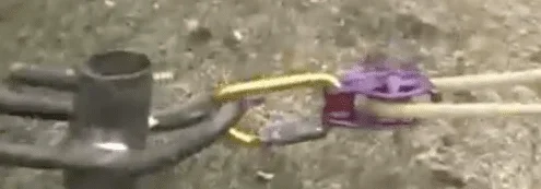

I regularly use the portawrap in a capacity similar as shown in the attached picture. I think I remember seeing in a video that you said that the top connection on the RC2000 is only rated to 250kg WLL? Do you have any data as to the shear strength of that in a straight pull?
