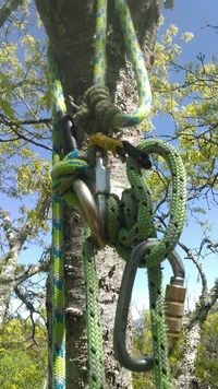

Good video. I've used the first pinto set up for years and got away from it due to dropability of the pieces. I went to a simple ring and bowline that a very good friend of mine was using. I like the second pinto set up except the knot blocking concerns. And I like the ring idea with the bite. I set it up in the office with the wife's arm and it does retrieve... at least the way I interpreted @Jehinten s description.

Please excuse the hardware. It's all rated, but I don't happen to have a revolver handy
Dang things loaded in the wrong order
First is the loose setup
Third is loaded
Second is pulling on the retrieval side
I think the wrench is arguable. I believe richard mumford made a video showing you don't need a wrench to achieve the required torque.
The downside I have found is setting it from the ground the ring in the throwball turns sideways and takes some effort to get back down.
View attachment 44378 View attachment 44379 View attachment 44380
Third is loaded
Never mind with a hundred feet of rope under it it's not gonna work :muyenojado::tonto::pcmala:

That is how I had it envisioned, although I have seen your later post and agree with you and @Toomuchsawdust that with a longer working end it will wrap over the limb and create to much friction.
Does anyone just use a Quickie on an Alpine Butterfly? Simple, bomber and as the slic pin rotates, reduces a bit of friction for pulling redirects.
Yep.
