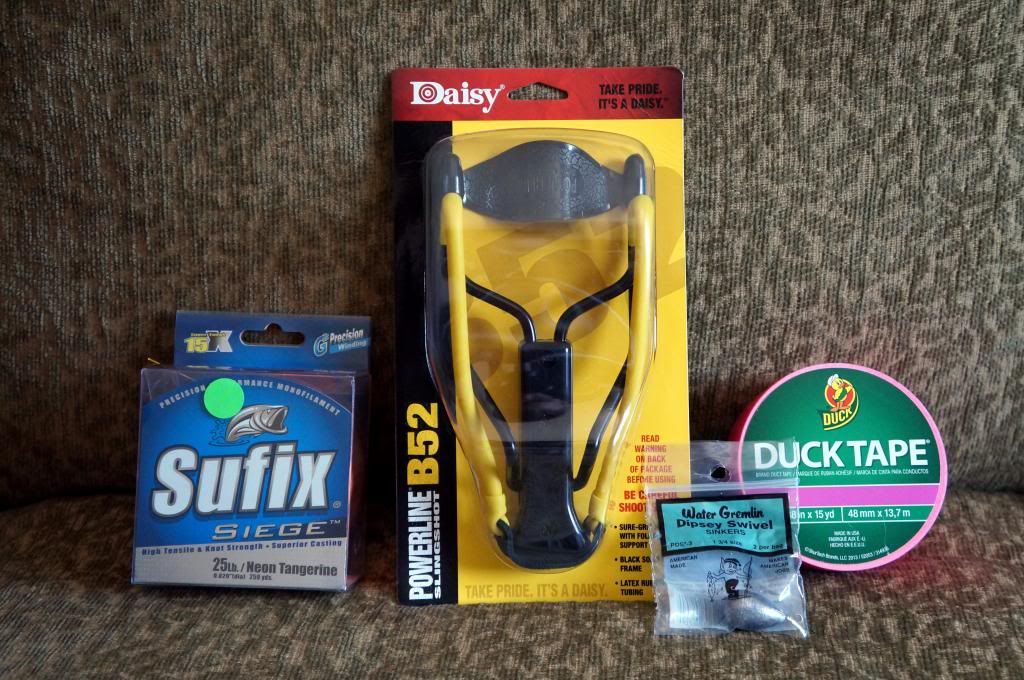

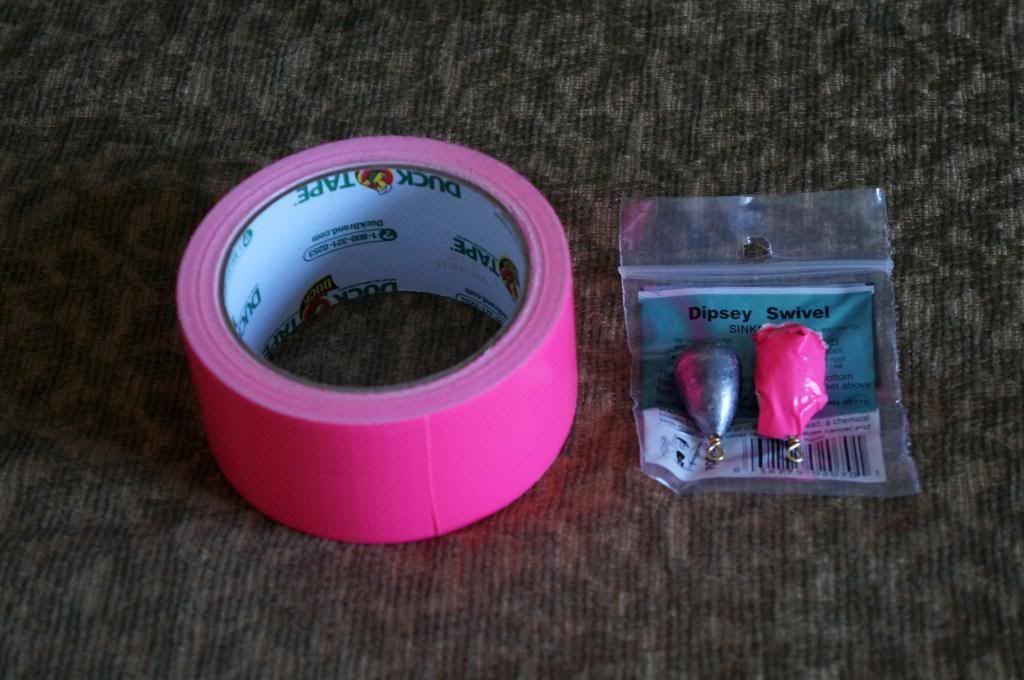

I basically copied and pasted the following from my website http://treefool.com/2014/04/07/diy-cheap-throw-line-slingshot-vid/
Originally I wanted to build one with a fishing reel that would allow me to easily respool the line but after a GanderMountain employee came up with the GENIUS idea of just shooting off of the original spool that the line comes on I decided to save an extra $50 and do it that way!
Materials Needed:
25 lbs test line – I paid $3.50 for highvis orange on clearance
2.2 oz fishing weight – $2 for two, I returned and purchased 1.5 oz weights which work better
Slingshot – $9.99 for a cheap Daisy “Wrist Rocket”
Bright Ducttape – PINK! $3.50
What to do:
Step 1 – duct tape the throw weight so you can see it after your shot
Step 2 – tie your fishing line to the weight using your favorite knot
Step 3 – lay the spool in a non-obstructed area
Step 4 – SHOOT!
Step 5 – tie the fishing line to your usual throwline (such as Zing-It or DynaGlide) using an overhand knot
Step 6 – pull it over
Step 7 – tie your climbing rope to your throwline and pull it over!
I have never used a big shot but I can hit 50-60 feet pretty easily with a small weight. There is too much drag, even with fishing line, to shoot any further than that. I use a chalk reel for my throwline in the tree, but with fishing line it curls up instead of flaking into a pile so when you shoot it there are a bunch of tangles. For that reason I have found it is easiest to just shoot off of the spool.
