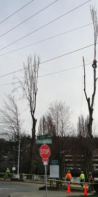

7 days have passed. Today I again photographed the tree removal at 34th & Phinney by the Army Corps of Engineers contractor. The work area was marked with yellow ribbon. The crew was wearing Personal Protective Equipment, such as chaps, hardhats, hearing protection and eye protection.

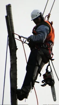

Some disturbing behavior by the crew involved supporting a large cut limb with a rope that was wrapped around a traffic bollard. The bollards are to prevent cars from driving into the canal, not for securing rigging lines, thus, a violation of ANSI Z133.1 safety standards. The climber was tied to this cut limb (another violation), and the rope accidentally slid upward and nearly popped off the top of the bollard. This could have caused the climber to fall or get stretched by the limb, which weighed about twice his body weight.
Last weeks action was well documented by video also, some of which appears on YouTube. This discussion thread is active on treebuzz.com, with links to the video and photos.
Todays videos are here and here. The attached photo of the unsecure rope should be good for a thousand dollar fine by L & I. This is a good example of how not to do a tree job.
No need to click on the attachment, this photo is it.

Here's the view from across the street.
Hope this photo isn't too big. It shows the size of the climber at the far right. These trees were planted during World War I, which ake 'em about 90 years old.

Here's a real Cowboy.

The outfit doing it wasn't even the ones awarded the bid. They are doing the seawall, and were offered the job. so, they hired a bunch of yahoos, and went at it. $70,000 for 42 odd trees, way low, even for us, I think, though we'd be about 4 times as efficient. Sad thing is, lombardy poplars or no, 90% of those trees were fine, and won't start declining for years and years. They knew nothing of any ANSI regulations.....all climbers are slow and backwards, and they have inadequate equipment....meaning no lowering devices or rigging lines, and nothing but an open 6 yard dump truck to chip into with the rented chipper.
