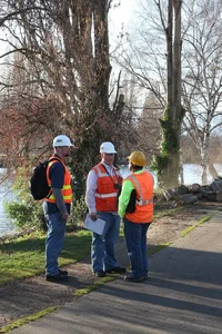

The photo in the attachment shows RBTREE documenting the investigation by the state compliance safety & health officers.

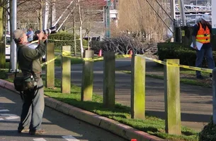

Attachment shows unspectulacular photo of chipping into a pile on the ground in an unsecured area, open to the public. The Burke Gilman Trail is a former railroad right-of-way, about 9 miles long across north Seattle, with about 300 pedestrians & bikers per hour at this spot.
This later became a bone of contention as video shows the Surirat foreman threatening to physically remove me from an unbarricaded area. The poorly delineated work zone resulted in the cops receiving 5 trespassing calls, when we were actually just occupying a public area not marked by barricades.
There were 4 climbers simultaneously working in trees over a quarter mile of waterfront trail, so the single foreman was unable to effectively supervise the job. The 2 trees on one end were being worked on by non English speaking crew, who were unable to communicate with the public when limbs crashed through the ribbon, all the way out to the centerline of the street. It didn't help that the foreman is not bilingual.

The chipper was later moved to the opposite side of the pile. Here's a side view of that same area, showing 4 pedestrians.
A video of the NBC news camera person shows 2 people walking right in front of the chute.
