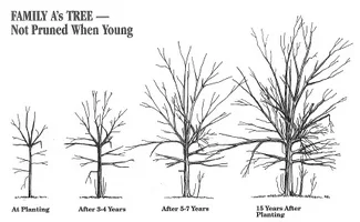

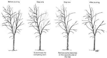

Yes, others have set you on the right track. The other thing I would suggest to keep in mind, after the tree is happy and healthy, is to get the pruning under control in the trees younger years. Don't wait until it is huge to think about what shape it should be. Pruning the tree when it is young will save you and the tree from a lot of trouble. To start off...make sure it has a dominant leader...that is to say, one top! You don't want a tree to develop with two tops growing from one union. And you should never "Top" the tree!
https://www.arborday.org/trees/pruning/
