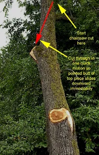

can someone illustrate the "salami cut"? muchas gracias.
Believe this is what he means. At least this is what I've used. And yes ... the thing come down pretty fast.
Ignore the bark tearing this image illustrates, and just pretend it's a straight stem section of Lombardy Poplar.

I didn't quite get what you meant at first. If what you are talking about is described in the photo that Mario posted, then it is called a "spear cut" or a "dart cut". A little underside nip, I have found is helpful, too. Very dangerous but helpful in dismantling pecker pole pines that you can't lay out: just a series of 4 foot chunks, preferably stuck vertical into the soil for easy pickup and removal. But you've got to watch where your feet and thighs are. Did it once and it came down onto my thigh and I was out for a day or two with a brutal charlie horse. I don't think I would recommend that cut for someone climbing in the tree, except on very rare occasions.
