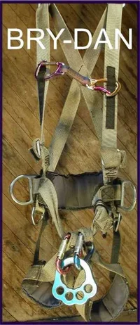

If you want a saddle that fits well and last a long time and is a leg loop body positioning device then may I suggest looking into a Weaver saddle called a Bry - Dan saddle.
