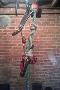

So, is anyone still running the pinto pulley set up? I set it up and looking at it my only concern is the rope running so close to the eye splice of the hitch cord. Obviously we have rope on rope contact - but, as limited as it is in this area - is there a concern? Here is a picture that may help what I am describing.
I don't think there is. I have thought about the same thing but it would be in all the same places if it was in Doubled rope technique which it can be used for.
I wouldn't be concerned about the contact at all, only time I'd give it thought would be using a hitch cord like 8mm Bee Line or HRC, where the eye splices are the exposed core. The core doesn't have the same heat resistance, but it's still fairly high. Just something to keep an eye on. But with cords like Ocean Polyster, which you're using, that concern is null and void.
