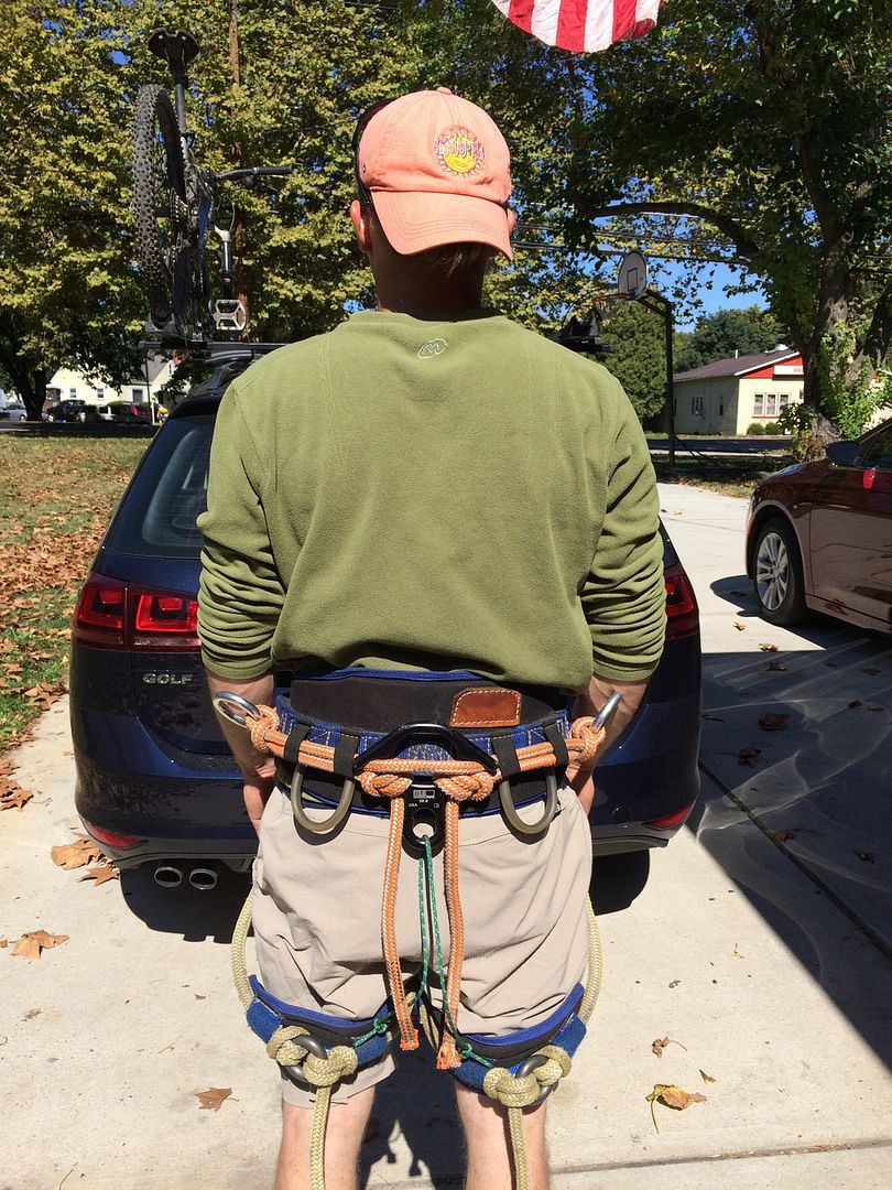

Rope is coreless 16 strand.
Color coded to show the 3 main parts.
Most comfortable setup yet.
Fig 8 for connection point around waist and leg pad lengths
Yeah the waist and leg pads are from an old buckingham empire saddle. My first one was all dyi but the leg pads weren't firm enough and waist belt really dug into my ribs
