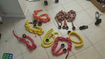

I love the rings. Blocks and pulleys I use for other stuff then standard rigging. They add frictions, hang close to cuts, and are waaay cheaper!
I ditched the two ring set ups because of personal opinion about bend radius. But that convo is for another thread, and for big weights and long runs.

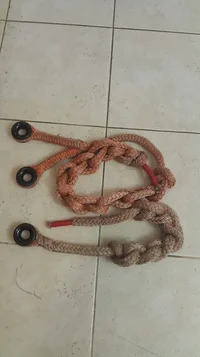

I use long single rings and rR versions, then when it's time for wood I use a klemheist or 6 coil prussic with the two rings on the single ring sling for negative rigging.

Another vote for rings. You can make a double ring (large) sling with 5/8" or 3/4" tenex for under $100. Tree stuff is having an awesome rope sale right now, just picked up 200' of 9/16" husky (similar to dynasorb) for $150. Can't beat that. Personally 200' is as short as I would go.
