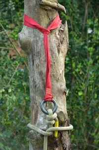

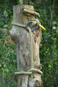

NYClimber,
I dont have a picture handy but its pretty simple... take a rigging ring and tie it to the end of your rigging rope.
Take a sling/loop runner/etc (you can take a pice of rope and tie it in a loop for all it matters)... Put a biner on it. Choke the sling around a log/branch with the biner on the end of the sling. Clip the biner to the rigging ring. CUT.
Here is a picture from one of Swingdudes posts @ the treehouse.
Replace the biner tied to the rope with a rigging ring. Put the biner on the sling and clip it to the ring.
Re: Rigging \"shortcut\"?
Another pic of the Maxim runners. Courtesy SingleJack
