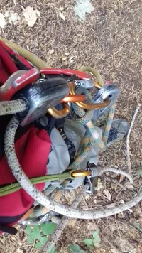

Biggest drawback to rock harnesses IMO is the lack of side D-rings. I've climbed lots of trees in a rock harness but you can't get too fancy with redirects without being able to secure yourself while slacking your main line/system.
So, Joshua Burr has been using a croll on a short tether that he keeps tidy on his harness for exactly this use, although it is on a pro harness. It's not a really cheap solution, but it is a light one for rec purposes. It's also very fast to set.
What's the problem with attaching a lanyard to the belay loop?
Not even for one carabiner? That's all you need if you choke the lanyard or use a hitchclimber.
No, not with a carabiner already in there, connected to my system. I put a small DMM bat plate on a Petzl Ring Open, giving me three holes to work with, but after awhile, the bulkiness of it seemed ridiculous for a rock harness. Why try to reinvent the wheel? Still use the harness occasionally for a quick climb in a short tree or to hang out in a tree hammock.
I get what you mean with the bulkiness and getting cluttered.20191010_170917.webp
