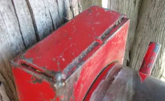

we have a big, red ratcheting bollard. It had a very sharp edge we hadn't noticed before, as it sees little use.
see attached pics..
pic explanation: The camera angle is misleading in these pics, but the trunk was growing at angle over the roof. We were using the bollard to tension the pieces and lift them so we could slowly swing them out away from the building.

pic explanation:
the device had a sharp edge, and the angle at which we placed the bollard put the rope in contact with this edge.

pic explanation:
this is the damage to the rope. Fortunately, in this instance, we were able to simply set the piece back down, shorten the 300' piece of line by 50', and get on with our day. We flattened the sharp edge with a flat file, and re-mounted the bollard so that there was no contact.

I agree with Brendonv. The rope, under high tension, is still bending around a tiny radius. Bigger than before, for sure, and only a degree or two of bend, but the rope doesn't like it a bit. Instead of cutting the rope with a sharp knife, you are now cutting it with a dull one...
no, I'm not. In addtion to rounding the dangerously sharp edge provided by the manufacturer on a very expensive piece of equipment, we now pay a lot of attention the angle of the bollard when placing it to ensure that the rope does not ome in contact with it.
I will contact the manufacturer and see if they suggest end-user modifications. If they are fine advising me to go out and weld on it myself, that's what I'll do.
