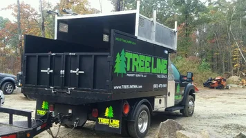

2016 f550. Only 4500miles so far so can attest to it long term reliability. I think I got 4.88s, I'd have to look. Happy I got 4x4 and auto for getting into tight areas and for bad weather. Pulls a 14k loaded trailer and full load of chips like it's not even there. Love the l pack, Especially on a smaller truck where you wouldn't be able to fit a very big under mount. This is the primary rig for me and carries 90% of what I need.

I would really value knowing what your rear end ratio is and what you feel are reasonable freeway cruising speeds for it empty.
Also was your solid main truck sides a commercial build? Those gates look like they lock up well, are they fairly rattle free?
