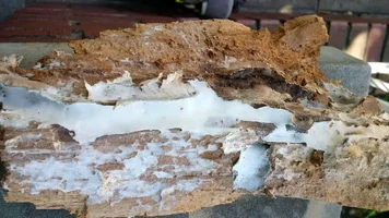

While in NYC I often find large (12-14") Ash branches having broken off an otherwise healthy looking tree. This latest one, in a rare Black Ash, I was able to inspect and the heartwood of the broken branch was thick with white rot. IMG_20160609_122759.webp
I work in a semi-educational setting and I wish to keep this specimen, however I certainly do not wish to be contaminating myself on a daily basis with this white rot and then, as my job requires, go climb Ash trees all day long! I am seeking ideas as to how I might best preserve this and keep it from contaminating my work area, thank you!
If your goal is to not serve as a vector for this decay organism, simple air-drying should do the trick. Even if it were fresh, simple handling of the sample followed by a day of climbing would not likely result in new decay infections. With other types of pathogens, I'd be more cautious.
Was there ring shake involved that prevented the movement of water into the heartwood?
I'm not familiar with ring shake. All i know is that when a piece of the heartwood dropped and hit the sidewalk it sounded like it had been ten years dried out (and felt that way too)
