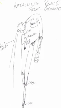

Mark do you have a way to set the RG from the ground?

I do snarf took me while to work it out
and sometimes can be a pain to make it work.
I will try and explain...
you need two throw lines.
First throwline stick tricked through the main ring with a throw bag on.Put your second throwline through the pulley in a continuous loop pull the main ring up and over the branch and drop the bag back to you take the bag off and put on a small crab clip it on the loop round both of the lines in the loop and pull it up and through the ring this will pull the continous loop through the ring and bring it back to the ground pull on both lines in the loop and the pulley jumps through the ring open the loop and tie on your life line pull it up and through the pulley and you set only problem is you have to put the rope through the retreiver when you get up there.
hope you can picture it Its hard to explain....
I don't know if anyone else has come up with the same solution as me.
