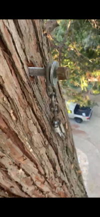

Earlier photos kind of show why I’m wary of the cobra style cables. Have never installed one, but the reality that so many cables are set and forget, homeowner change or some other factor it just doesn’t seem worth the risk.

The homeowner hired one of the local tweeker tree services to install a cable in a big codom cedar next to his house. This is as far as he got and then presumably ran out of meth and disappeared. He had a long drill bit broke off above this and a long spade bit completely through the stem but stuck and abandoned. On the other stem was an eye lag but it was screwed into the stem sideways to the intended pull of the cable. Seems like there was some other random piece of hardware up there too
I wish I had photos of the elm I saw cabled. I started getting super critical of the concrete in the cavity, and the super low ‘cabling’. Whoever installed it used chain instead of cable. It dawned on me that this was probably installed more than 70 years ago, and whoever did it was using the best practices of the time with great care for the tree!
