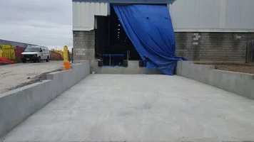

When we did one several years ago, we drove our truck tight alongside a sunken loading dock like this. Then get a forklift down in the pit and slide the entire outrigger down and out of it’s holder.

Digging a deep hole was my idea as well when I was looking at mine and saying "I hope I never need to take that apart" I like the idea listed above with the loading ramp. Not only do you not have to dig, but you can work standing up like a normal human being. Instead of upside down in a hole.
