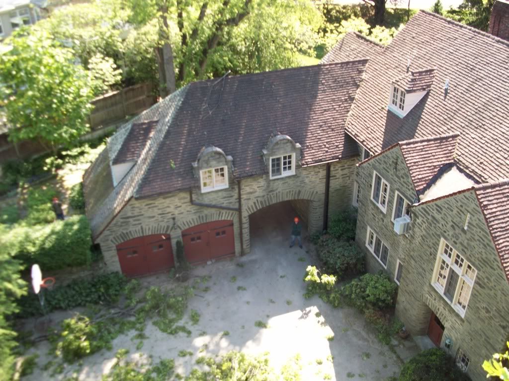

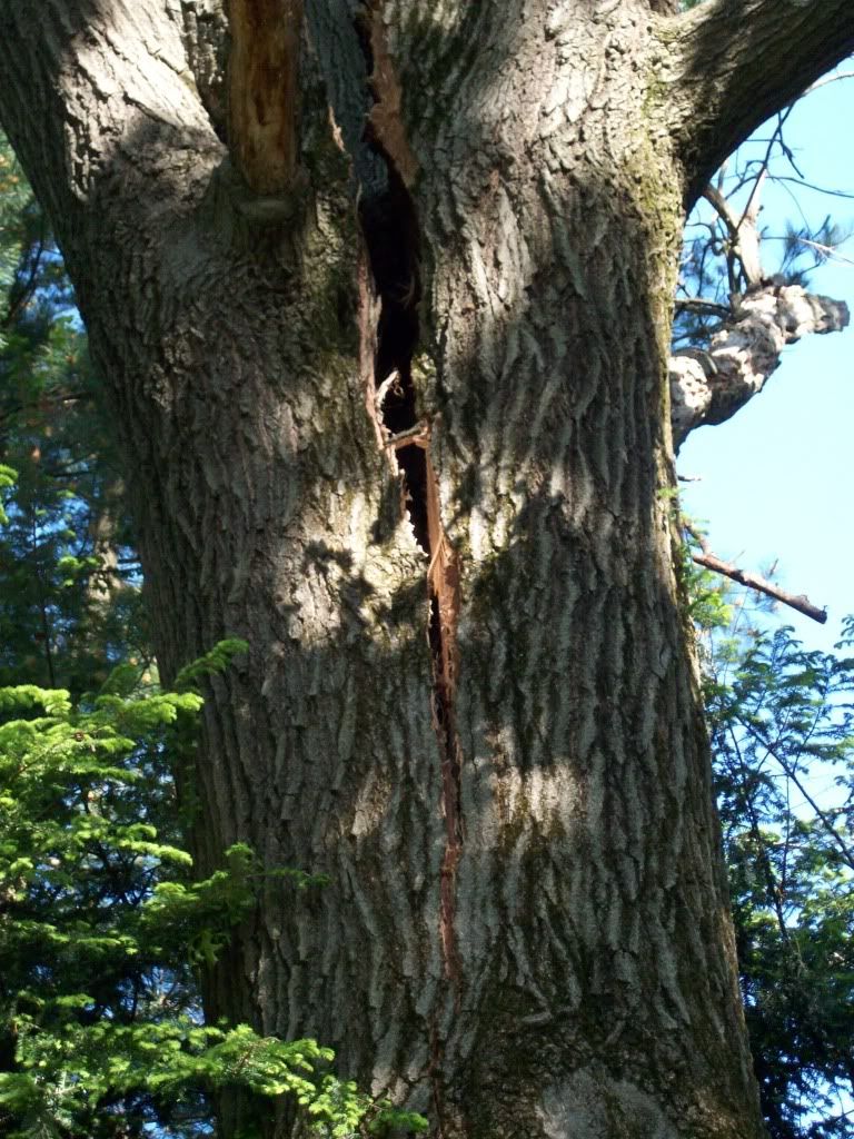

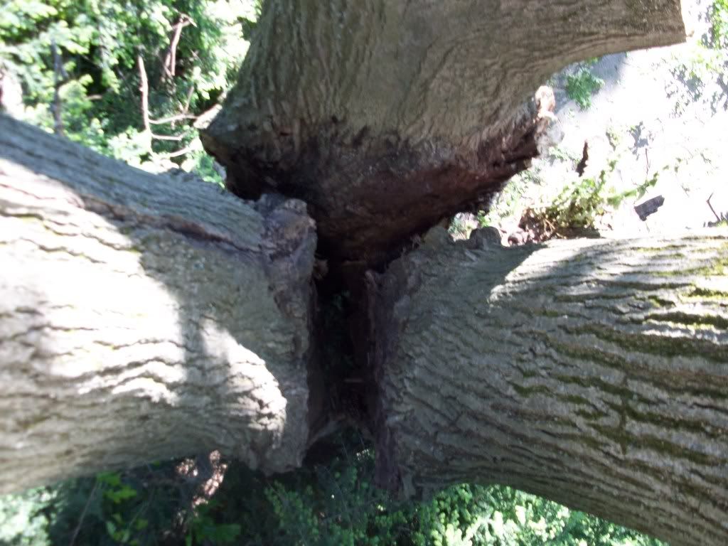

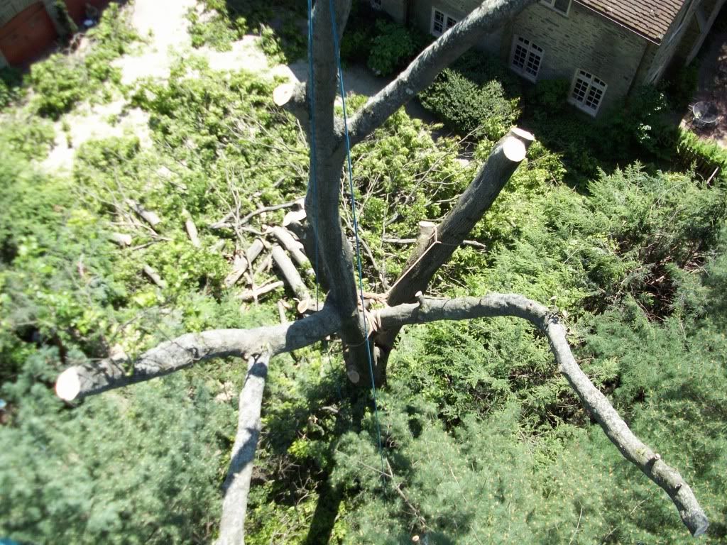

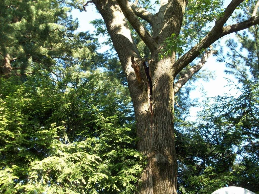

So Sad . The Philly area got hit with hard winds on Saturday and sunday. This oak was hit hard on Sunday , the 9th . A three stem Red Oak , hanging over three properties , two houses and a pool . The only acsess by a hair and a crap load of cribbing was the one house to the back . The tree was breaking and all neighbors were happy that some fool ( me) would help them. Land lock your property , who's the fool ? Anyway This tree split on Sunday , it had no cables (?) Look at this split click here , it was still windy on Monday , the tree was gonna break click here , I didn't want to set up my truck , they love there houses and pool but I love my truck( 75ft. feva aerial lift). Cool job , I'll do it , no crane acsess Click here . 9 ft. arch way . I barely got my bucket in the neighbors. inch here inch there. The tree was compromised click here I hammered that tree , gonna finish it on Saturday. Tied it up , lowered it , Ghostbuster style. Truth be told , by noon it would have fallen , and smashed two houses. I did it for the high , pictures and beautiful ladies. If that tree fell and broke my truck or almost killed me I would have burned their houses down ( kidding?) . Hey , how about some preventive maintinence on your old tree ? pruning , cable , hello !

Winch , I never met the people till that day . I kind of am a tree man for the treemen. This tree was probally let be because of acsess . All three stems separating is odd. We didn't talk money yet , I have to take the logs out on saturday. This one tree guy showed up , saw it , than went in the owners house for a bit , butterflies click here , he didn't get the job . I 'll post more pics when it is done . I lowered quite a bit in the driveway click here . I spent four hours getting all the brush and some wood out of that tree , than I had to go to another job . Everybody was happy , no damage. I took weight off of the lead over my truck first ( first rule of rescue , don't become the victim ) than I slammed the lead over the driveway with flatcuts . After all the brush was off that lead , I than tied the trunks together. There is a method to my madness, I than hung a block and spun all the brush and wood into the driveway . talk to you Sunday ....Go Flyers!
