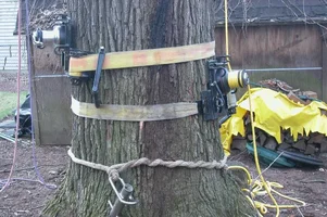

Double Whip Tackle correct. We did use two GRCS's for that job. We tensioned the dwt and just left it alone. I did leave the slings and block in the tree because I was lazy and no threat of them getting damaged.
I forgot about that article at least somebody read it. I like to use rope in some fashion to help secure splits. I feel the tree should stay dynamic and be able to absorb some of it's own energy.

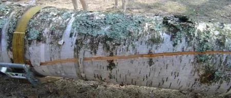

Do you think rope is a better choice than binder straps when securing split trunks?
I agree that the tree should stay dynamic to a certain degree, but I like the static tension that I get from using those 10,000 lb binder straps spaced every from few feet around a cracked stem.
In fact I just used them 2 weeks ago on a job with the GRCS and Hobbs Block. Great combo, I'll try to post the pics tonight.
It's not much of an article more of a story. Not alot of technical info.Maybe the powers that be can put it here? As far as bindings go I only use them for smaller trees when the seperation needs to be put together. I will also use rope higher up to support the upper load. The upper load needs to be protected more than the seperation it's that weight that will make the seperation fail.
Tod, are you using a dynamic line then? Or am I missing something? Also, when you tension using the GRCS and the DWT, how much tension do you apply?
I will use some type of double braid. Depending on how much mass is there would decide how tight. I would say pretty darn tight. The double braid will still stretch quite a bit. This way you are not disturbing the natural enviorment of the tree and still providing protection or should I say hazard reduction for climber and crew.
10klb. binder straps haven't failed me yet.
Thats a perfect use for the straps. The trees I've posted had much more mass hanging very far from the split.I think they would not work. Kathy, there have been many trees I could not rig or get a crane or lift to. So the client may have to move something or we may damge something.
