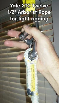

I currently use Arbormaster, XTC 16, Forestry Pro, XTC 12 and TreeMaster... and have used a couple of others in the past.
(PICS WERE TAKEN WHEN ROPES WERE NEW)
