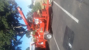

In ran Vermeer for years then made the switch to morbark and will never look back. I have a 12" disc -M12D and a brand new this spring M15R. I managed to get a tier 3 142HP CAT in my new 15R instead of tier 4 with all the emissions garbage on it. The 12" disc doesn't process smaller limbs as nice as a drum but it cuts a perfect chip when chipping logs and throws chips HARD! The 15R is a tank!! Yes its heavy but its built to last and I would put it against an 18" vermeer any day. I got the solid non fold up feed table because we feed it with the big and mini skid steer. My 15" vermeer had non stop problems with feed rollers plugging. Chunks of dead ash or oak would get jammed behind the feed rollers and stop it. I would have to pop the springs off and pry the rollers apart with a big bar. Waste of time and a pain in the a$$. Then there is the electrical garbage on the vermeers. sensors, switches, solenoids always screwing up. In my opinion there is no need for that stuff on a chipper. We are chipping wood not splitting the atom. Morbarks are built tough and are a simple design and they eat wood. We are cutting dead ash about 4 out of 5 days a week and I have never had a feed roller jam up on my morbark like the vermeer did with dead hard wood. My experience with vermeer is that they are under built, under powered and over priced! They also lock out all their part numbers so you have to buy from vermeer only $$$$$! I was looking at the new vermeers at the TCIA expo with that wireless "tree commander". A cool idea but what happens when that starts screwing up? Wireless remote control box out side in the rain, snow, salt, vibrating while chipping.....NO THANKS! You get a lot more infeed pulling power with morbark or bandit with the hydraulic down pressure compared to the spring setup with the vermeer. Its handy for limby or crotchy material. I would say go with morbark. A friend of mine just got rid of his year old vermeer BC1500 because it was non stop problems. He got a 1390xp Bandit. I have only seen it in action once and it will chew!! Stay away from vermeer. Try morbark or bandit. Good luck!
This doesn't show you how great a morbark is but it does show you how s#itty a vermeer is!! You don't wanna be that guy standing behind that vermeer waiting to put the next piece in while it takes 2" bites at a time! TIME = MONEY!!!

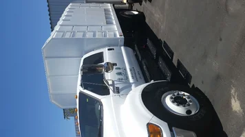

damn jeff how tall is the truck your chipping into! thats a solid chipper right there. just keep an eye on the welds on the end of the shoot, ours rattled off eventually and is now a snub nose.
That's one sharp lookin' truck, Jeff!
(the sideways pic being a result of your inhabiting a land of avacadoes, sunshine, and pot, but the full size pic comes out fine)
