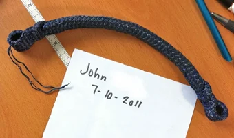

I've attached a pic of a bridge I made a few weeks ago. This one came in at 10.5" long. Here it is after it's first Maxijacket coating.

Here's a pic of the finished product. It did go to a fellow tree-buzzer so if he stumble's upon this, he might recognize it and can maybe chime in.

I recognize that bridge
