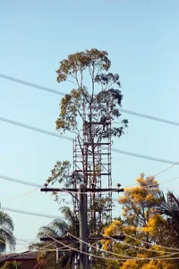

Anyone have any pics of using scaffolding on a sketchy tree? This makes me curious. I wonder how long it takes to set up 50' of scaffolding and take it down
not much crown spread
Or just multiple setups of the same set of scaffolding. (Left side branches, right side, back, front, trunk, etc.) I'm certainly not saying it's ideal, but scaffolding rental is pretty cheap compared to a large crane, easily carried by hand, erectable on virtually any surface and any terrain, easily conformable to any shape and sometimes may be the only option.
Remember in 1984 when they completely enveloped the Statue of Liberty? (Google it Steve, I know it's before your time)
Never thought about scoffolding. Interesting. Who knows, maybe comps in the future will have a scaffolding event. Not viable for everything, but it does make a lot of impossibles possible.
I've spent a bit of time working with scaffolding in other industries, it can go up surprisingly quickly when everyone knows what they're doing. It looks like he braced it to the tree in that picture, have to take care not to put any side load on it, small pieces. A ring scaffold surrounding the tree would be self-supporting and much more stable, but use 4-6 times the pipe as well as the time factor. They even make heavy duty scaffolding that could be used for rigging. Museums and churches move statues this way all the time, for example.
